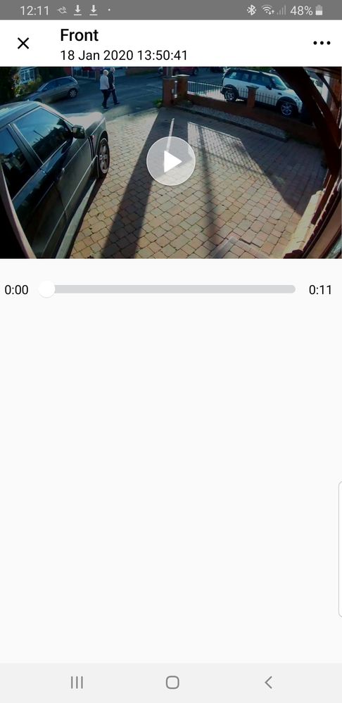

Hi,
I have an arlo pro and my front camera is on a smart plan. I have activity zones set up for on my drive and my smart notifications are set up to give me alerts on animals, vehicles and persons (other motions are turned off). However im still getting alerts for other motion and all other motions occasionally outside of my zones. Iv searched here but cant seem to find a fix. Anyone with any ideas please?
Please see the 3 screen shots below, hope it helps

Motion Notifications ( which is turned off) and its outside of zone

  What troubleshooting steps have you tried so far? I do not want to suggest anything you may have previously performed.

Iv tried to delete the zones and re zone them. Iv re set the cameras. Iv un subscribed to the smart plan then re subscribed. I think i must have tried it all. Iv even spoke to arlo but no joy.

Is this cam recording outside of the zone when the camera is unplugged & plugged in charging? Have you tried to delete & recreate the zones over the web portal?

It does record out the zones plugged in and unplugged. Iv not tried the zone set up on the web portal. Does it make a difference on the web portal as oppose to the app?

I have seen in the past deleting & re-creating the zone through the web portal sometimes helps.

Tried it doesnt work

Does lowering your sensitivity help with motion being detected outside of the the activity zones?
Hollowman1
No. Modifying the sensitivity doesn't make a difference.
The objects being detected show (car, person, etc) but they are outside of the activity zones so it shouldn't alert me.
