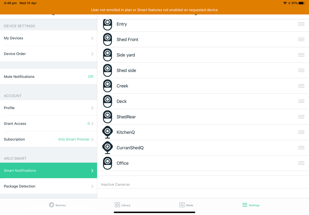

Just noticed one Ultra camera has dropped out of the Smart plan and does not record any motion or audio. Tried to add it and I receive a message stating some errors. Tried Deactivating and re-adding another camera and it joins back up fine.
Have tried removing and re-adding but nothing gets it back in the plan.

Yes I tried that but no luck. It doesn’t seem to like this one particular Ultra camera even though my plan states it is for ten cameras.
It always comes up with that error message of user not enrolled or smart features not active on that camera.

Removing and reinstalling has no effect. It still gives the same message when adding it to the Smart list.

I have found a solution. (I think)
Working with the app on an iPad or android phone doesn’t show enough information.
I saw in the documentation that the web site should be used.
This has worked and also told me that my plan only allows 9 cameras even though the Arlo App tells me 10.
I have now successfully re-added the problem Ultra camera but have had to remove one other.
Now to sort out how to get that extra camera on a plan.
