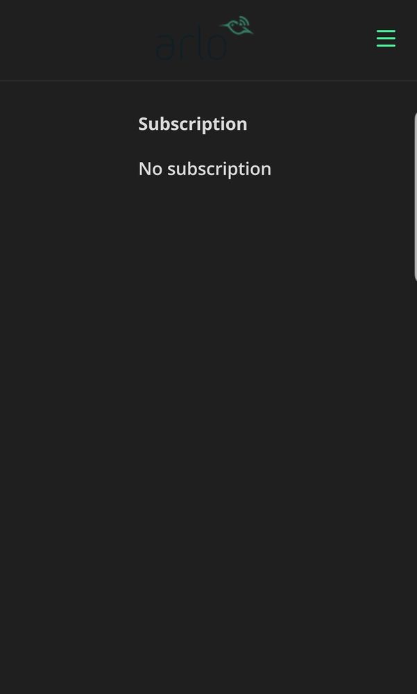

@dcfox1 I have tried the link you provided. I click to 'Subscribe' on the plan, and it takes me to an empty page which just says 'No Subscription'... attaching the image

See attached image when I click 'Subscribe now'through the app... takes me to an empty page..
It would seem to be a display issue unless there's something built into the backend now that detects the different location from the original. Are you using a VPN? If so, disable it. Otherwise, all I can suggest is to use the Contact Support link at the bottom here. Be sure to use a Canadian credit card if it ever gets going.

It's my understanding that the original country that the system was set up in is the one used to determine eligibility for subscriptions. If you really did set up in Dubai, that would be the issue. I would think that removing the system from the existing account and creating a new account with a different email address now that you're in Germany would fix the issue. Of course, I believe you'll also have to use a German credit card from now on.
