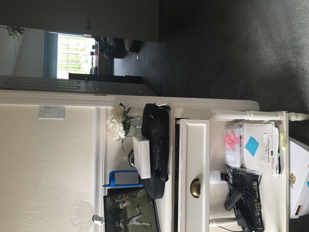

Yes, moving the bridge 5 ft closer to the back of the house enables the backyard light but disables the front yard light.  Since it is communicating with at least one light, my assumption is that the stucco is not the issue. If I position the bridge in the outlet behind the bedroom door, it can communicate with the backyard light, but not the front. It current location communicates with the front yard light but not the back. I attached a picture, if I move the bridge 5 ft closer behind the bedroom door, it works with the back yard but not the front.

From your description, it definitely sounds like the walls are causing an interference issue. Is it possible for you to try finding a central location for the bridge and relocate the lights until they are able to maintain their connection with the bridge?

Unfortunately, the wire mesh supporting the stucco works like a Faraday cage. That's why it works fine when placed so only a window is in the way. A second bridge or different locations for the bridge and/or lights would be choices unless JamesC can come up with something else.
