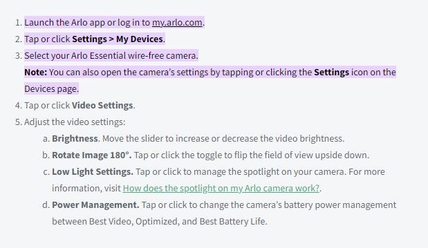

Where can I find 'Settings > My Devices' on Android for my Essential wireless doorbell?
I'm trying to complete the install of my Essentials wireless doorbell. I've found these steps from a Google search...
I've found 'Settings' after clicking the small head & shoulders icon at top left of the home screen, but on the next screen (my account profile and security) there's no obvious trace 'Device Settings' or 'My Device' etc... Am I barking up the wrong tree? My doorbell has got the latest firmware, downloaded today during installation, and the Arlo Secure App on the phone is V 4.11.2_28633, release date 23rd Jan 2024

'Home' --> 'Devices' just takes me to the live view through the camera lens. If I select the head & shoulders icon on the home screen, this takes me to.....
No mention of Devices. However, I select 'Home' and get this:
I select Devices and then 'Arlo Doorbell' and voila! Bit of a scenic route to get there.
