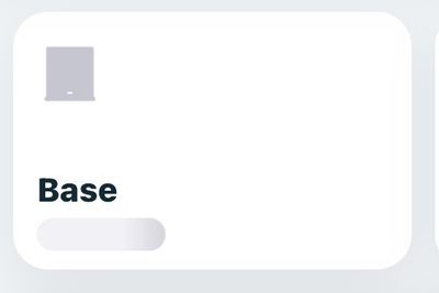

Hi and thanks for the reply!   This base has been in service for many years and done relatively well.  It’s just been in the past few days that it’s not working.   Attached below is what it looks like in the app.  It doesn’t officially show offline like it would if I unplugged power, but in the messages it does say Offline.   I will try resetting everything (painful) later today and will report back.  Thanks again.
Before you go too far, are you getting recordings as expected? That would show that the base is working so a reset wouldn't be needed.

The 5 cameras which need the base to work are in a similar state.  They “appear to be offline” and they have the same grey bar that indicates they are trying to connect with no luck.   No recordings.
