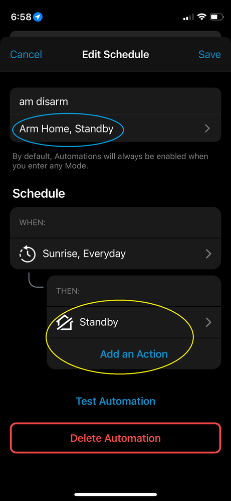

@Khone wrote:
Please excuse my ignorance, but what is "the enabled list".
This is the list at the top of the automation.
Here are screenshots from my iPhone - they will look a bit different on Android or the web app, but the information is exactly the same. The "enabled list" is circled in blue, the action area is circled in yellow.
If you select the list at the top you see this:
That is where you choose the modes that you want on the enabled list.
@Khone wrote:
I apologize for taking so much of your time. This this has been driving me crazy. I thought I was smart enough to figure it out, but, I'm totally lost. Obviously the actions do not mean what I thought they should.
FWIW, I've told Arlo directly that the automations were too hard.
The stuff at the top (the enabled list and the scheduled time) are things that have to be true in order for the automation to run.
So in my screenshot in order for the automation to run,
- my system has to be either in Arm Home or in Standby mode. If the system is in Arm Away, the automation will NOT run.
- It also has to be sunrise. If it is another time, the automation will NOT run. (Your automation should say 7 am here).
The action list at the bottom tells the system what to do when the automation runs. In my screenshot, the only action is to change the mode to Standby.
