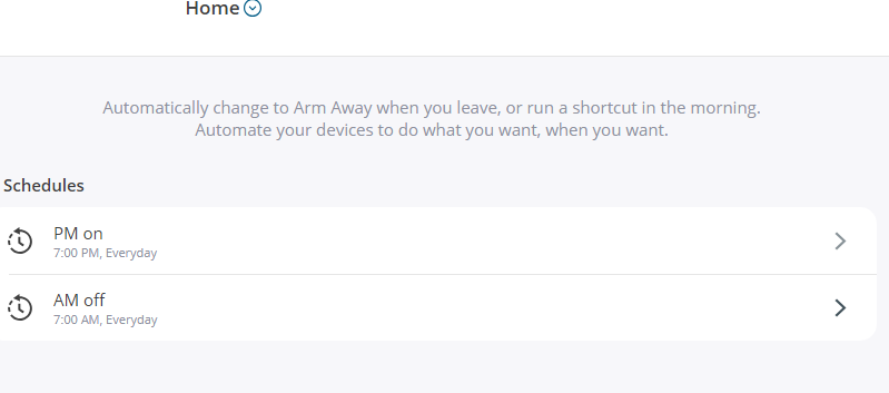

Here are screen shots that work (though times are not the same as what you want):

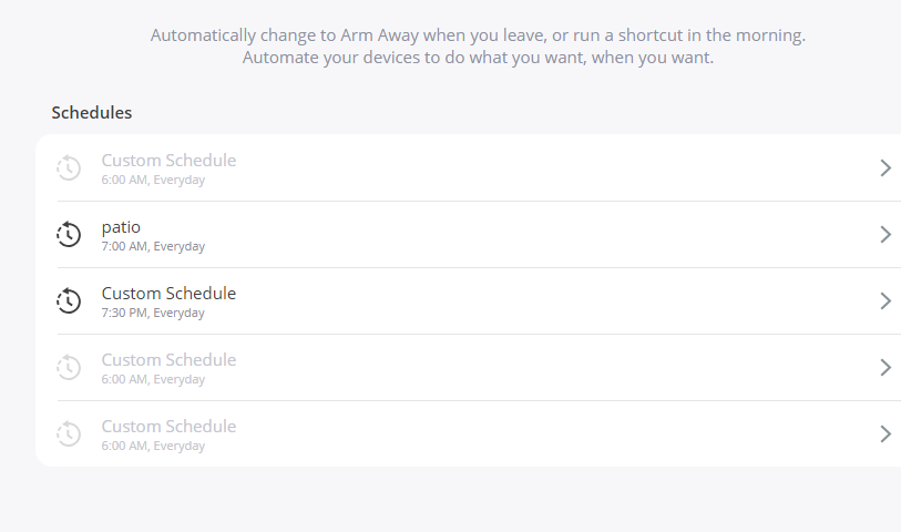

Yes, I've been trying to do it manually. There is nothing on my ARLO that says "schedule automations". Never had it before either. This is what I get when I select Modes and Automations
@Khone wrote:
Select Patio, and post the screenshot you have there. Also post the "custom Schedule" right underneath it.
The other three custom schedules that say 6 am are likely ones you created, and you should probably delete them.

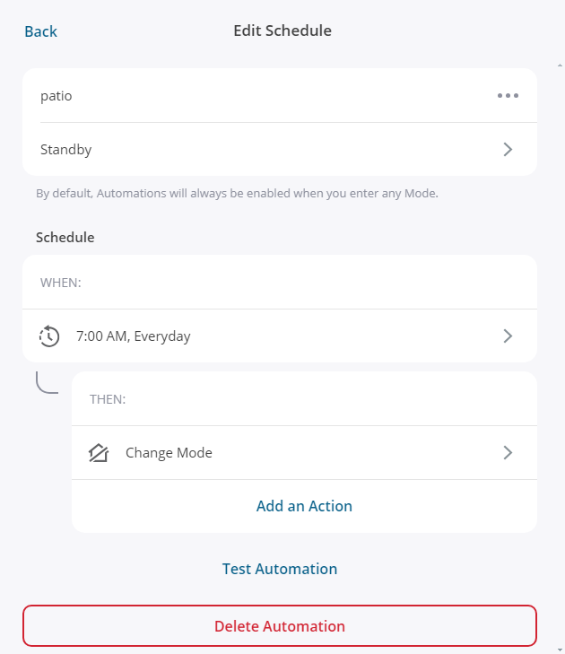

Here's what you asked for
@Khone wrote:
FYI I thought my camera was in standby (not on recording) but it is on.
The "Standby" on this screen is NOT the mode you want the system to switch to. It is a list of the modes in which the automation will run. In your case, it should include "Arm Home" and "Standby" (same as my "am disarm" post earlier). The way you have it set up, the automation will only run when the system is already in "Standby", so it would have no effect at all.
The "Change Mode" in the action below is what tells the automation what mode to switch to. That should be set to "Standby", since that is what you want to happen at 7 am. (It might be already - no way to tell since your screenshot doesn't show what mode it changes to).
