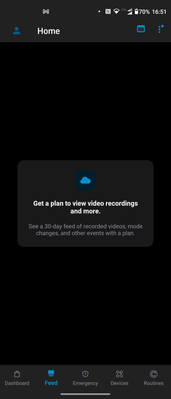

yes, just after installation they were visible in "Feed" sheet but now they are NOT

i updated to 5.5.2 28806 and always the same issue, i think we are forced to get a plan...

both methods(cache clear, reinstall app) do not work for me(android)
even jumping between Dashboard and Feed page. i see only "nice" invitation to get a plan...
I thought the same thing as I saw the new app and the hidden access to local recordings(a few steps are necessary to get them...) if this is a conscious plan it's time to say good bye to Arlo!
