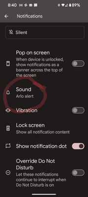

Sorry, but this is not a solution. I had (on IOS) and still have a personalized Arlo alert tone on Android. Allow us to create a personal tone for IOS. That's the solution.
