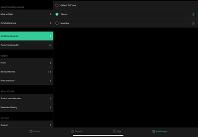

Thank you for your patience while we worked to deliver a solution for the iOS notification default tone change. Three notification Tone options are now available within the iOS Arlo app. Vibrant and Marimba are the new alternative tones available for users who do not prefer the default iOS Tone.
After updating your Arlo app to the latest version available from the app store, you can find these new options under Settings > Notifications > Notification Tone.
If you do not see an available update, you can manually install the update by opening the App Store > Tap your profile icon at the top of the screen > Scroll to see pending updates. Tap Update next to the Arlo Secure app to initiate the update.
You can find detailed instructions here: https://support.apple.com/en-us/HT202180

Amen to all the concerns mentioned in this thread. As a senior with some hearing loss a more powerful, louder Arlo notification sound is imperative for safety! Please address this. My updated app does not show an option to fix this!
My updated app does not have these alert tone options… would love to have the tri tone or marimba..but not showing in the Arlo app and I have the latest version.
Yes, agree with all the comments here. We need a fix. I have an iPhone 13 pro plus with the latest iOS and have changed my notification sound to Marimba but it still uses the iOS default regardless, and it is way too soft.
