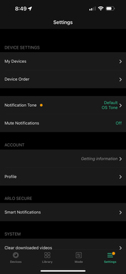

Also on the setting menu under “account”, it keeps saying “getting information” just like the other user seems to be experiencing. Obviously not an isolated case.
ShayneS
Is it possible to provide a screenshot of the "gathering information" messaging?

ShayneS
@Dbensette
Thanks for the SS.
