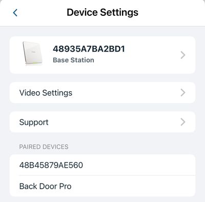

Base station is VMB3000.
If it is still working, there is likely no reason to take it out of service.
If you want to pair currently sold cameras to the base, you will need to get another one. The best options are the VMB4540 and the VMB5000 smarthubs. Both would give you the option of adding local storage. Some use that instead of an Arlo subscription, others use it as a backup. (I use it as a backup).
Can you look on the base for a label with the part number? - it should be VMBXXXX. The graphic looks like you have a VMB3000, but it'd be good to be certain.

Yes on both.
Oldest camera runs on CR123 batteries.

You'll need to remove the cameras on the old base, and add them back to the new one.
