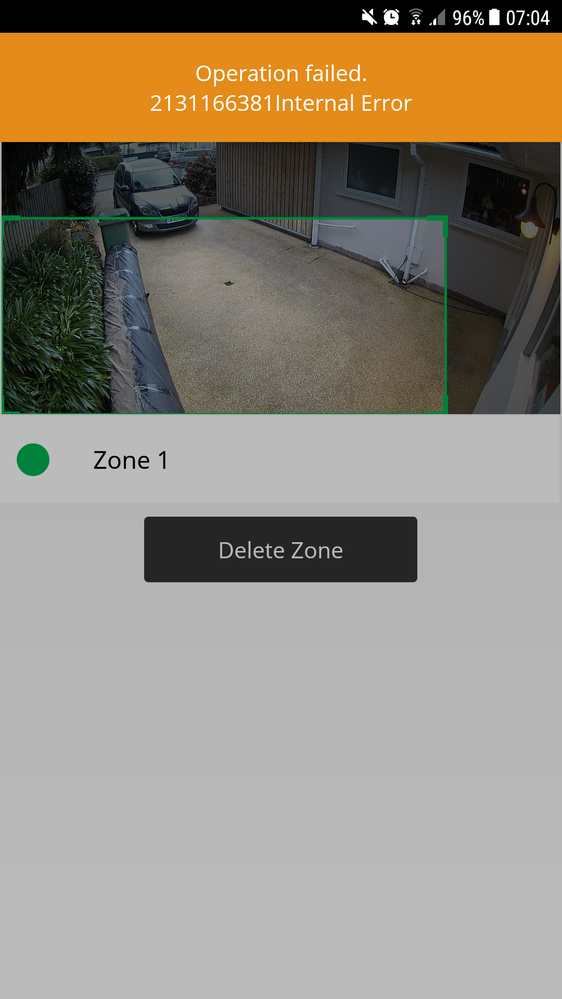

ALRO Q setup underneath eves of house and now cannot modify detection zones at all. I get an operation error. See screenshot.
phaedrus2k,
Try deleting all of your motion zones, save, then recreate. Do you still see the same error?
Just tried it here and it's working fine. Maybe restart the camera?
