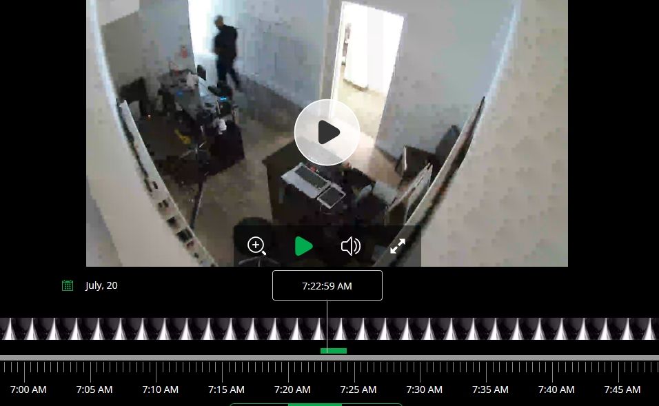

Also in CVR the green motion bars do not correspond with actual motion. Blue bars are not showing, yet there is audio. I bought this camera for my business and I have to be able to count on it, not to go through half a day without any audio recorded. I'm starting to regret my purchase.no motion at a time.no motion at a time.
Quality terrible at times again. Audio recorded but not marked as blue line.Quality terrible at times again. Audio recorded but not marked as blue line.
