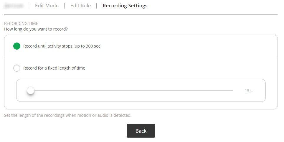

good news! last two days my Q functions as it should. i don't remember everything that i've done, but here's what i remember:
1. removed the zone;
2. changed resolution from 480p to 720p;
3.there is also this setting (check the attached file), which might have something to do with the problem.
