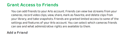

If this was something that was not intended to be supported I would think they would put that information in the sharing section of the manual, which it is not as you can see from the clip from the manual.
