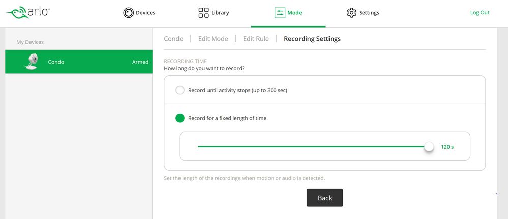

1. Software app. No matter what I set the video clip length to (up to 120 seconds), either from the Arlo PC website or from my Android phone, it reverts to 16 seconds. Also, the video settings randomly revert back to 720dpi, and randomly turn on Audio functions, which I have turned off.

1. "Save" was done each time I tried to set the time length. The camera disregards the setting and only records in 16 second bursts. Re-open the app, and the setting is back to default. Tried this several times, and it is repeatable.

I received my new replacement camera, and it went through setup without issue. It immediately updated the firmware to 1.8.3.2_17494, and hasn't nagged since. Everything seems to be working good with this new camera, except I am still stuck with 16 second video clips, even though I have the video clip length saved at 120 seconds. Maybe I am missing something, I don't now. If I could only get that to work, I'd be satisfied with this camera.
