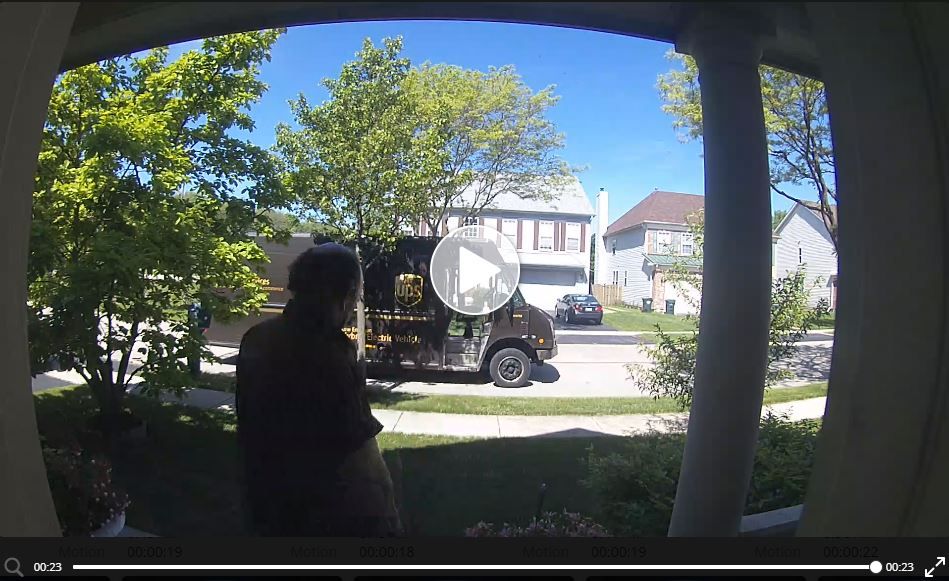

My Arlo Q shows a recording time of more than the time it actually records. One video shows it to be 58 seconds long but it actually stops recording at the 30 second mark (which is where I have it set to end recording). The video stops at the last frame but the marker keeps moving to the right for the remaining time (28 seconds in this case) but shows noting new and the sound stops.
This is a screenshot of the delivery today. He backed up and ran out to make the delivery and the last frame of the shot is of him heading back to his truck. The next video is 3 minutes later of a different car driving by. The one from yesterday shows UPS guy pulling up, walking towards the front, and then it stops. Next video again is minutes later.
The settings are on "Record until activity stops (up to 300 sec)" which has never worked right. Sensitivity is set on 6 without any zones and i get all the cars driving by. It is set to record on motion with night vision off. If i set it to a set amount of time, my bandwidth usage would off the roof. It's ridiculous to have this setting when it can never be used.

I have tested it at the highest setting before and its the same issue. I removed the zones also thinking that could have caused the issue but its not. If you look at the image I uploaded, the guy was walking towards the camera and it stopped recording. There something buggy with these cameras or the software. I was debating between these and the Logitech Circle and that seems like a better product at this point. I dont think I am the only one with this issue and others have given up. Comcast has a 1TB monthly limit and with I believe a 1.5MB upload. Between the two cameras its around 200 videos a day give or take. .
