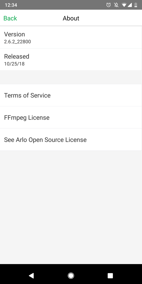

I just got 2 new arlo Qs and trying to setup with my android (pixel 2 xl) and I cannot select a wifi SSID and i just see [<unknown ssid>].
arlo version 2.6.2_22800 latest version

mrterry,
Thank you for the screenshot. Have you tried to reboot the phone, remove & re-install the Arlo Mobile App? Are you experiencing the same issue with the iPhone? I see you mention you can add them manually. You can also try & Install these Cameras with a different device if possible to help narrow down this issue.
