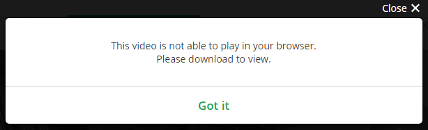

When I attempt to view this 10% of corrupted videos in the Library on the Arlo website (using Chrome, IE 11, or Edge), I get an error that says "This video is not able to play in your browser. Please download to view."

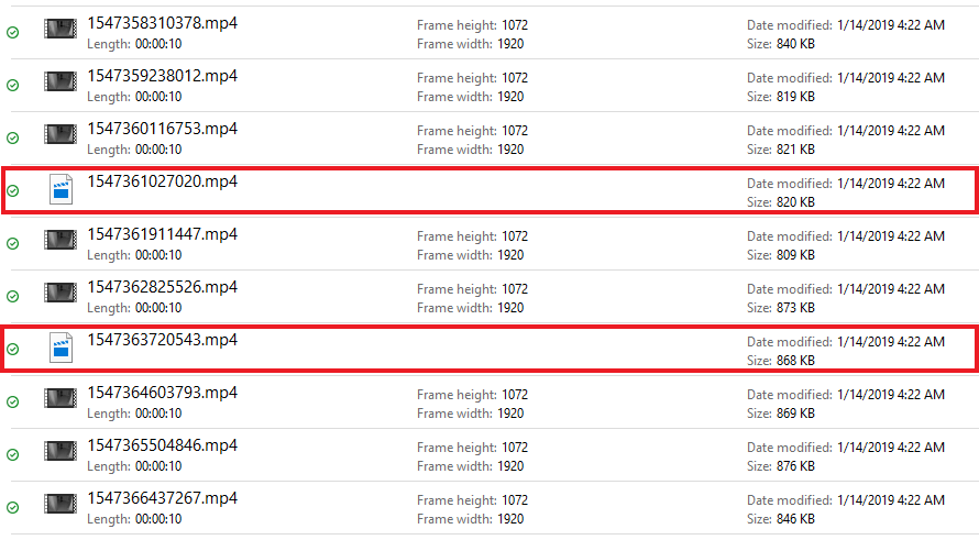

I have attached a screenshot showing 2 of the corrupt files (outlined in red) in Windows File Explorer.
As you can see, none of the details associated with an MP4 video file are visible in the corrupt files.

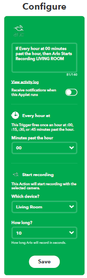

It has been happening for about a week, ever since I programmed a series of Applets on IFTTT to schedule recordings on my Arlo Q camera.
Basically, the IFTTT Applet is programmed to trigger a 10 second recording on my Arlo Q every hour on the hour (see attached screenshot).
The IFTTT Applet seems to be doing its job, as the Arlo Q camera is being triggered to record the videos.
