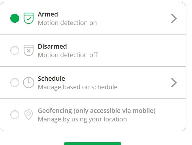

Print_B
Hi Brian, screenshot below

Print_B
ok - I have
Armed
Disarmed
Schedule
Geofencing
brh
Master
Master
@Print_B
Good. Same as Mine.
Click the green pencil next to the Armed Mode.
Under Rules what does it say?
Brian
