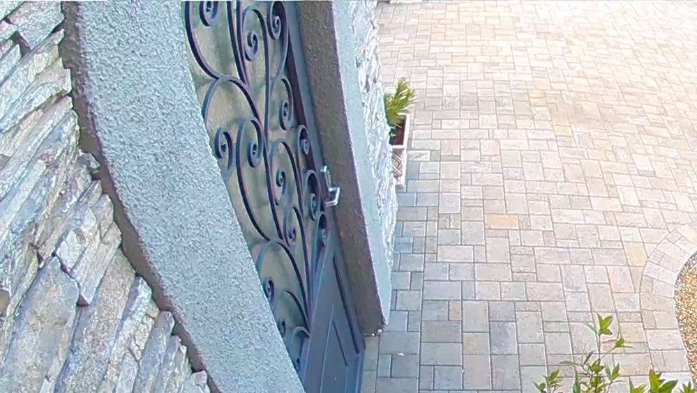

#1 if you can post a pic of the location, it would help get a better answer...
Also make sure yr adjusting the sense level in the actual mode used to arm the camera, or, see if you can place the cam away from the door facing same to allow a better trigger time
Pic looks good , tho I might angle a slight bit to eliminate more wall ( near door)
at night the ir might reflect a bit off same and wash out a little
what sense level are u using, I usu run about 90-93 percent
