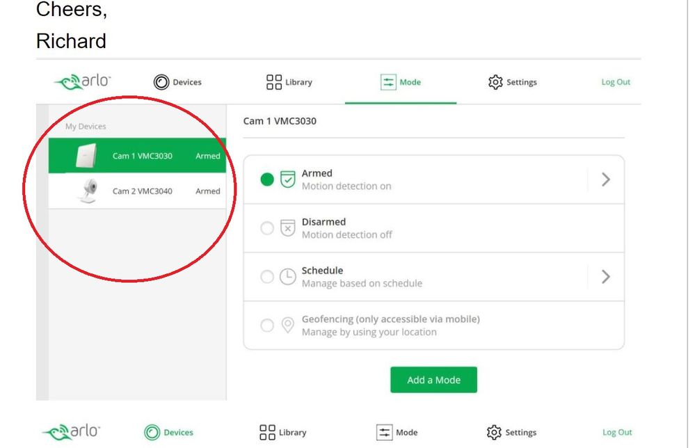

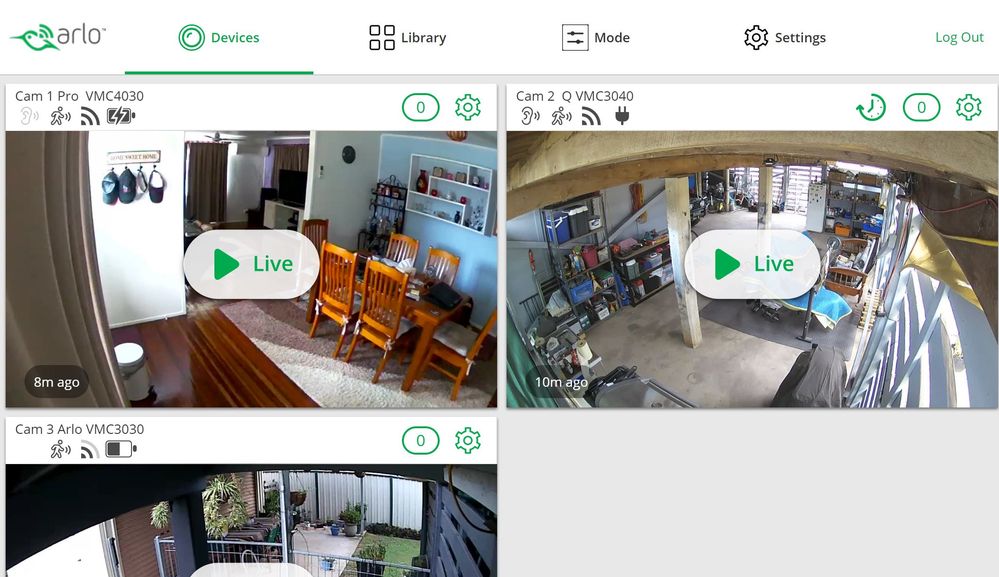

I have attached further screenshots.
As you can see all 3 cameras are displayed in Devices tab
When Mode is selected only Cam 3 (sadly picture depicts base station) and Cam 2 Q are listed
The Pro Cam 1 is not listed therefore I am unable to modify its rules.
Cheers,

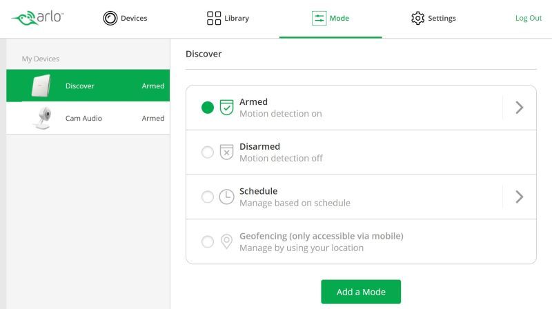

Select your base (click on it) and your modes will be seen.  Sounds like you are using the Armed mode (the default) so edit that using the > or pencil icon on the right and check it out.

For unknown reason the base station appears to be dedicated to CAM 3 VMC3030
Yes I can add CAM 1 Pro VMC4030 to CAM 3 in custom mode, but this is tied to CAM 3 rules
Ideally the new Pro VMC4030 is required to be stand alone.

I believe it to be necassary to populate the Device list as pictured with ALL devices in the system.
Arlo, Pro, Q and base unit.

I'm not sure exactly what you're having trouble with - I suspect you're just over-thinking things.
In the Mode tab, after you select your base, you get to the available modes.  The Armed mode is by default and is there to get you going with something that works as well as for troubleshooting.  There are limited options to modify it due to these needs.
It sounds like you essentially want to use each camera as if a separate system, ala the Q camera.  You do this by creating custom modes for the wireless cameras. You can't separate them since they're attached to the base but you can create modes that will suit your purposes for specific time periods.  Thus, one mode would have both cameras, another would have the original camera and a thrid would have only the Pro.  You can then manually set them active or, if appropriate, use the schedule.
