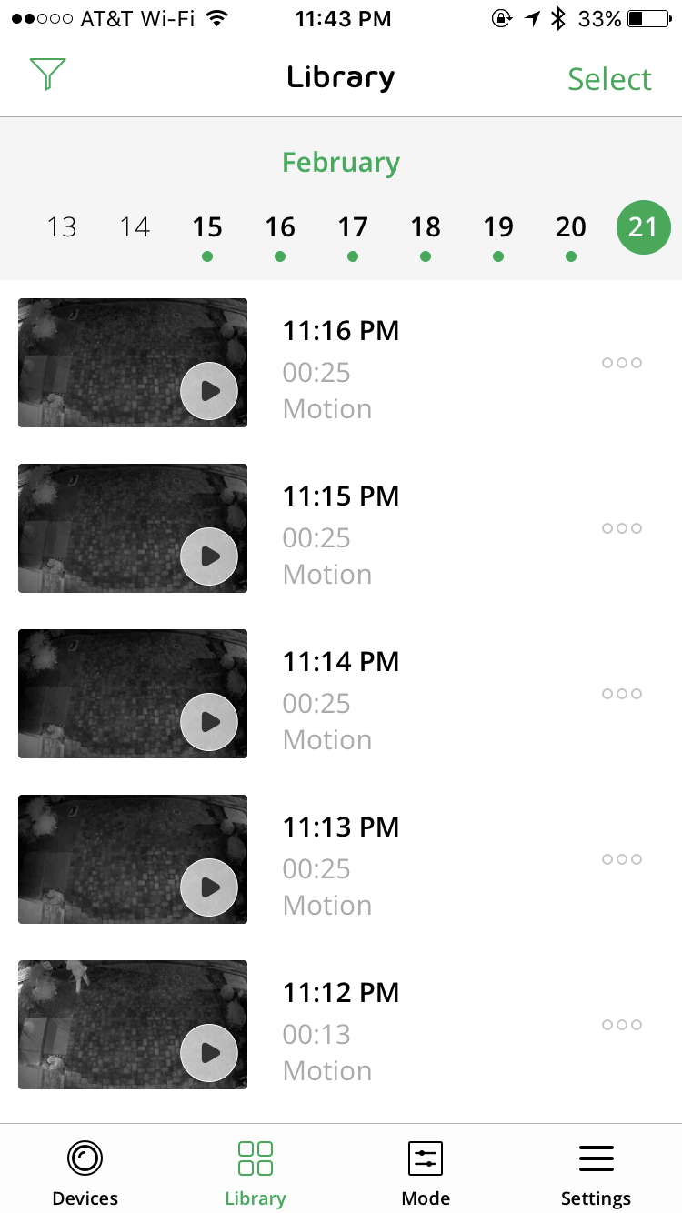

Update from me:
I decided to not return the cameras and instead, work with Netgear support. They are very nice and polite, but I have to say their RMA process is very slow and error-prone (someone told me I'd get all 3 cameras in one box but I only got 1. Then I had to call to re-do RMA for the other 2).
With lots of back and forth and at least 2 hours total of phone calls, finally I got all 3 replacement cameras today. And similar to other recent reports in the forum, ALL OF THEM WORK WELL. No more false alarm problems under nightvision. They are all H8 hardware version, but according to other posts, some H8 might still have this problem. So I can only assume later H8 hardware has better chance. JamesC mentioned their engineers have found the root cause. So maybe the fix is already in recent H8?
Ironically, my only old camera (the only one I kept from my original 4-camera set) today started to show the same problem, which didn't happen before. It's the one above my driveway. As soon as I walked by (legit motion), it started to send false alarm for another 4-5 minutes. Better than the other old cameras which never stopped, but 4-5 is still annoying especially at night. So I'm working with Netgear to see if they can also get this replaced.
I really really hope Netgear discloses the root cause and solution. We as customers have already spent lots of time and effort on the issue (some even paid shipping on their own), and not to mention the frastration we experienced. I appreciate Netgear's support eventually taking care of us, but I really hope the process is smoother and the issue is more transparent to public.
Thank you!
PS here's the screenshot of my driveway camera (the only one I didn't do RMA, but today suddenly started to show same problem):
