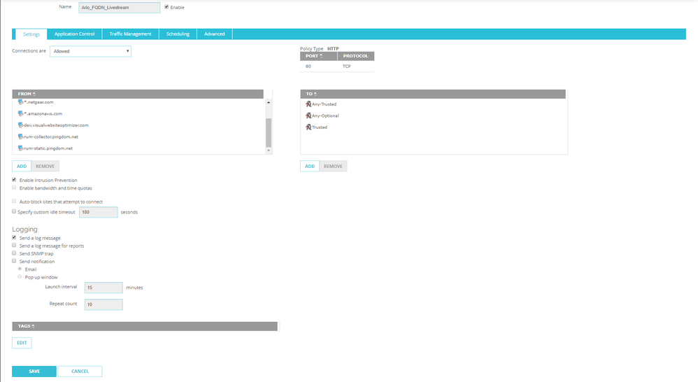

I also am using a Watchguard Firebox as well and I attempted to create an FQDN list as you suggested, but I still cannot preview live feed. Does yours still work with this list? If so, can I share a screenshot with you to see if I am configuring it the same way?

I've attached a screenshot of my policy as implemented right now.
I've also attached a google drive link as uploaded photos have to be manually approved by a moderator.
From what I understand, this is an outbound packet filter rule, not a proxy (If it was a proxy, the blue menu bar along the top would have a proxy actions option, and this does not. Again for clarity I am using your original list of FQDNs as listed in your first post.

I've just spotted my own mistake. I have the To and From fields backwards on the Firewall Policy. I reversed them and that has fixed it.
