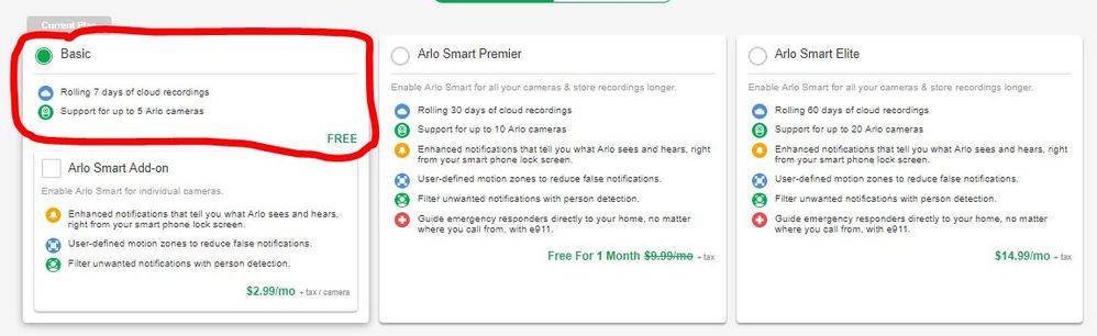

I have checked everywhere and I am not in the Smart Plan. I have and always will have BASIC. Today alerts took 5-8 seconds to go to my E-Mail and App on my iPhone.
I also added a screenshot on my settings, showing BASIC plan.
