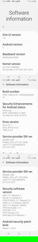

The phone is running Android version 9. I think that is "Pie".
I have attached an image that shows a lot of info on the phone.
