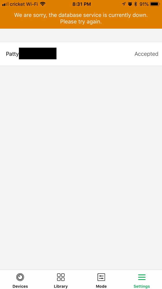

While trying to edit other users account, under settings > Grant Access > Selected User and edit that user; when I check the cameras I want to give access to (or Remove access to) and click save, I get the error "We are sorry, the database service is currently down. Please try again."
I've tried doing this same process on the website and although it doesn't give me the error, it doesn't do anything to the user account. Doesnt remove cameras, or adds them. I went ahead and trie dto delete the user but the user stays in my account under Grant Access, but now the user doesnt have access to any of the cameras and I cannot add them back either.

I just tried to delete my wife’s account from the shared group and I still get that same error.
James do you have a workaround to maybe resync our accounts? I’ve tried deleting the app and re-singing in and still get the same error. Also, ever since I tried to delete her account, she no longer has access to any of the cameras and I can not add hem back because I get that same error.
