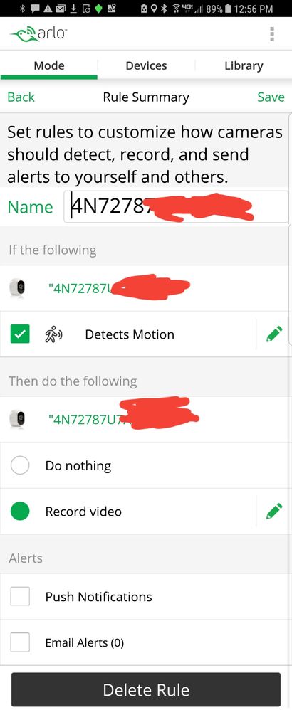

Matty09
I dont even have a smartthings mode in Arlo. I have 'Armed', 'Disarmed', and 'Schedule.'  I try and make custom modes for certain cameras and use them within my 'Schedule' mode, however I have been having the previously described issues. I have NOT been using ST mode in Arlo, and I do not even have a ST mode present as I deleted it almost immediately. All I want is to be able to use my Arlo Schedule mode + the custom Mode I created within it.

I have 2 of 5 cameras set up in the Custom Mode. Consistently the SECOND rule only gets corrupted. I've deleted the custom mode and recreated. I've rearranged the rules. Same issue everytime and NOT camera specific. Whichever camera is in the second rule gets reset.
