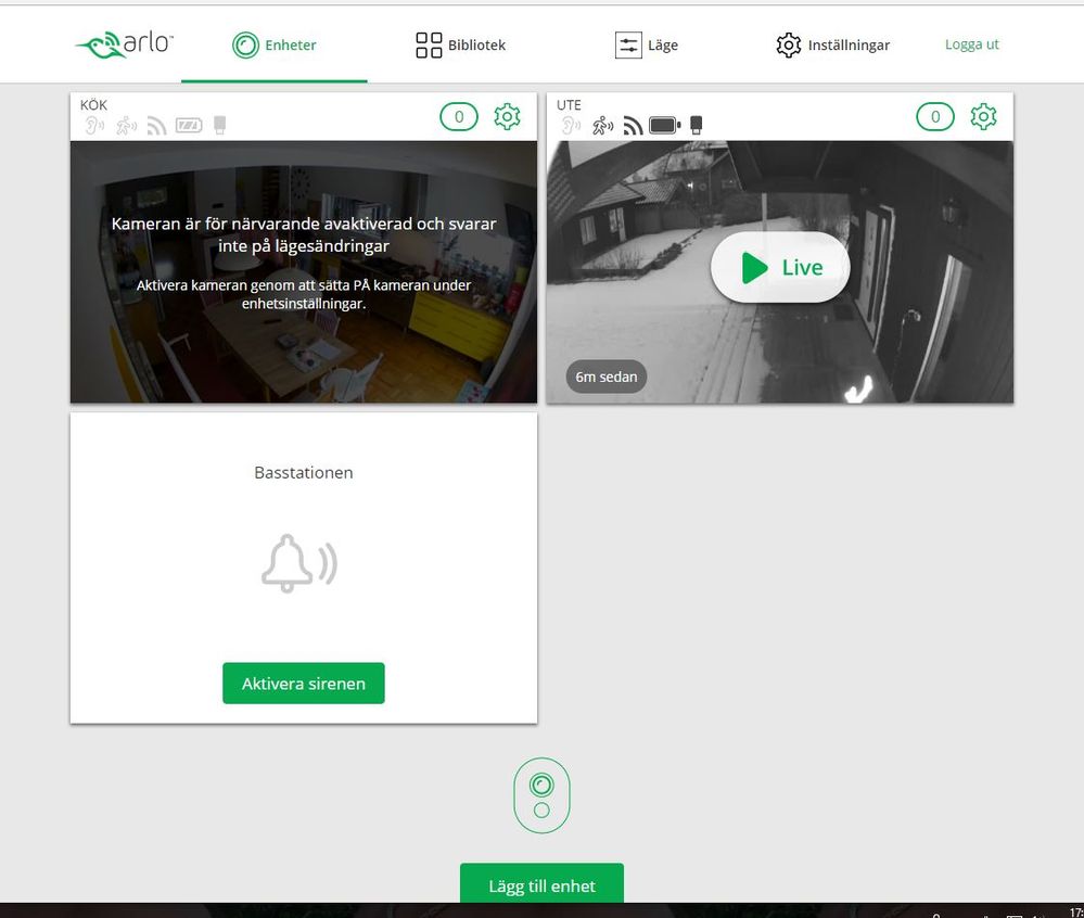

eTiger67
Hi, I can change email addres, but cant find where do disable the email-notifications... se pic

eTiger67
Thanks for reply, but I cant find any of your suggested settings...

eTiger67
There is no Green Pencil (no pencils anywhere).
Just installed this 2 days ago, with the latest update, maybe we dont have the same admin-system...?

@eTiger67
What mobile phone are you using?
I am on an iPhone 6.
Can you log into your account from a PC?
In your account on a PC the green pencils have been replaced by arrows to the right of the text.
Your picture won't be available for viewing until someone from Arlo approves it.
Brian
eTiger67
Iphone 7
Yes I can log in on PC, but no arrows,
ok, you cant se pictures

eTiger67
Hello eveyone who tries to help, very appriciated!
I found the settings now, (I even found the 'arrows', > ).
Very confusing GUI though. But the main thing of my missinterpretation  is because I have swedish settings on PC and app.
Fixt it! Thanks again all!
