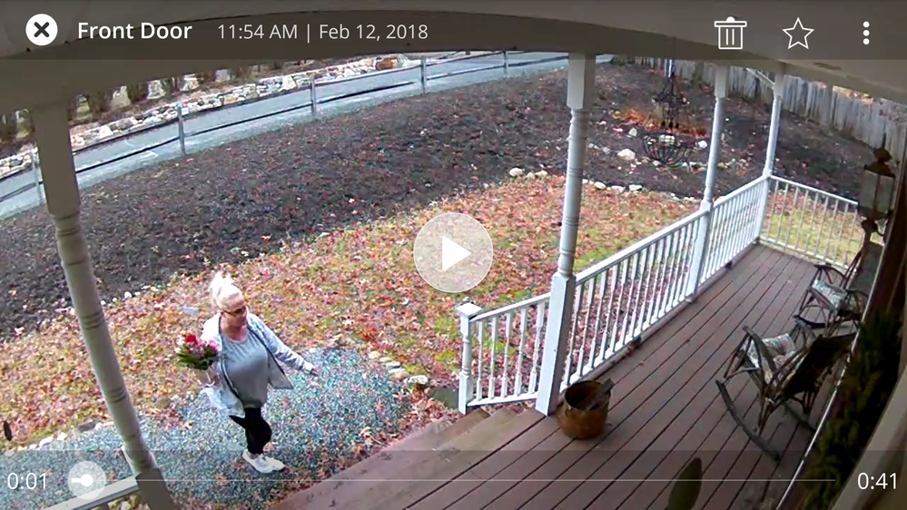

I have been researching the Arlo cameras and found a review that states that they cannot record a straight on approach, it has to be a side to side motion. Is this correct and if so, how does one monitor the front door as that is how one approaches?
Not correct , while it is true the cam has an easier job seeing motion accross the FOV than straight in, the cam will still detect straight on. It just takes a bit longer ( talking a second ).
BTW, the Pro has pretty good detection , the original Arlo was a bit slower.
( like above posted pic, the cam is positioned a bit off center )
As above, the Arlo Pro is pretty good with the motion detection compared to the original Arlo HD. It can detect objects moving directly towards the camera but it's not quite a good. With a camera above my front door to capture faces, I have a second camera at 90 degrees on a fence. Both of these cameras not only record on motion but they trigger each other to record as well via 4 rules in a custom mode. This, combined with fine tuning of motion sensitivity, gives me excellent coverage and recording of people and vehicles in the area of the front door
