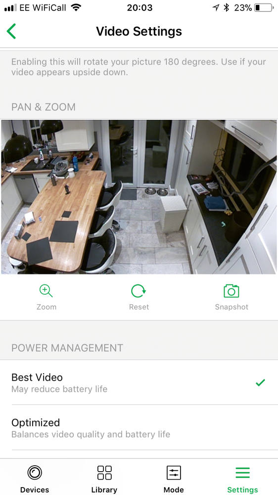

I have recently purchased the Arlo Pro 2 system which has two cameras. Despite them being powered, I do not have the option to create activity zones for either camera.
I have followed the instructions as per the user manual and online forum but when it gets down to the ‘’create activity zone’ I simply do not have that option. Any ideas?

Are you going to video settings for that camera?

Thanks for replying. Yes I’m certain it is the Arlo Pro 2, and yes this view is in video settings. I just don’t get the option. This is why I’ve been getting confused/frustrated.

Problem solved. Having spoke with Netgear who remotely accessed my account, turns out the cameras are just the pro.
Some cheeky b*stard has purchased the pro 2 but returned it with pro cameras, and I’ve been unfortunate to purchase the returned product. Problem is I don’t have the packaging to return it and maplins are refusing to accept responsibility for it 😡
