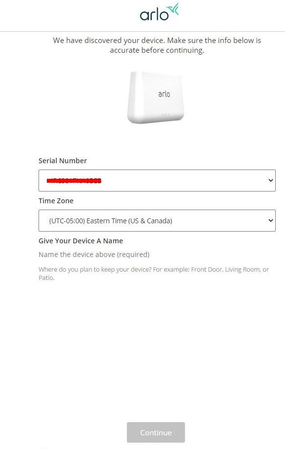

Arlo wouldn't let me login so I started a clean reset. During set-up (please view photo) arlo wont let me go any further than the page on the photo. I'm stuck! In the photo where the button at bottom shows to continue is greyed out and cannot continue. On the base station the three colors, the camera is a solid amber. I connected the cameras many times in the past but this time it wont connect. I'm using a home computer windows 7 - and the biggest problem is connecting the base station. Your thoughts please!

Thank you Danny but that wasn't the problem. When I went to my computer saturday night. I couldn't open up arlo. I tried many things but wouldn't work. This was all out of the ordinary . So I made another account. The problem occured when I tried to link the base station VMB4000. While and following instructions in my account to connect the base station, it brought me to a page that said add device ...please view in photo attachment. In the photo it shows serial number and Time Zone and a button at the bottom of the page that says continue. It is then that all stopped and I couldn't go any further. The word (continue) is greyed out and doesn't work when you click on it. This is what is precisely preventing me from linking to the bay station. That is my problem. I have a spare base station by arlo and tested it and it done the same thing. The bottom line is: my base station VMS4000 have 2 solid green lights (which is good meaning it as power and internet) but the third light is a solid amber for camera

Looking at your screenshot, it appears that you didn't name the base station (which is needed before you can proceed with the setup). The third light is amber, because you need to add the base station to the account before you can add the cameras.

Did you name the base station? It won't let you proceed if you don't.
Thanks for your response. Actually I couldn't name it because it wouldn't let me write anything. The box you noticed with the red line across was only I blocking out the serial number for privacy before posting it on arlo community. The serial number was already in the box when I got to that page.
As for making a new account. In fact I made 2 new accounts to try and fix the problem. After making the first new account, it done the same thing and didn't fix anything. So I made a second account to be sure and it done the same thing, so that eliminates new accounts.
Thanks for your response. During the process and when it got to that point, it wouldn't allow me to write anything. The box you see on that page with red lined. I was only hiding the serial number before posting the photo in arlo community. In that box was the serial number and I couldn't take it out and rename to my liking.
At the bottom of the page (the continue button) was greyed out and wouldnt allow me to click on it to go forward
