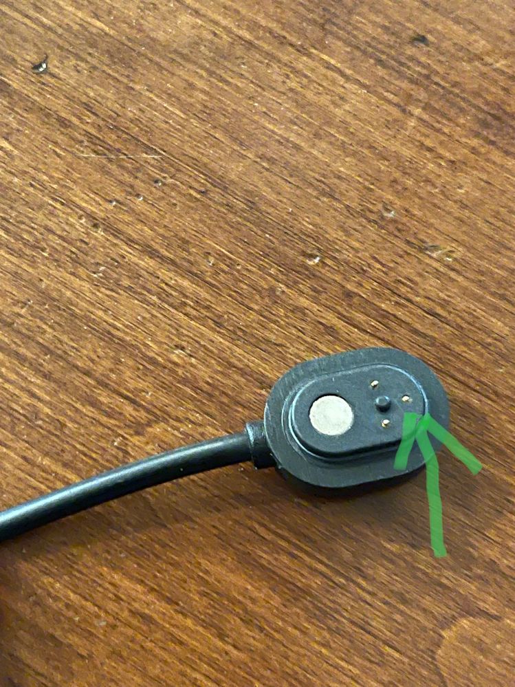

arlo_rg
Was your problem solved? I have the same problem with 1 of my Arlo Ultra cameras.

arlo_rg
arlo_rg
I had a chat with technical support today and was told that it seems like a HW issue and the camera in question needs to be replaced.

arlo_rg
arlo_rg
Update - I brought the Ultra camera that was misbehaving indoors and connected it to the Arlo indoor charger that came with the Camera. The Camera started working fine. My outdoors adapter and cable are made by Wasserstein. I tested the camera with the Arlo indoors cable and Wasserstein adapter and the camera worked OK. So in my case it seems that the Wasserstein outside cable has gone bad. After some reading, I ordered the OEM Arlo 25 ft outside cable (comes with a captive adapter). Will test before installing outside.

arlo_rg
In my case it was a confirmed magnetic charging cable issue. The spring in the marked terminal (see picture) was bad leading to a contact issue.
