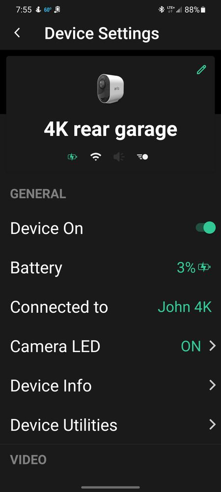

Arlo ultra plugged in , battery will charge to 100%. If left plugged in battery will discharge down to zero and go offline. At the time that it's discharging battery level in the app still says 100% it will keep saying 100% until finally it goes completely offline down to 0%. all this happening while plugged in. Yes I am using an Arlo charger and an Arlo wire. This whole process of discharging down to zero takes less than 24 hours. Yes I have refreshed the app cleared my cache. Like I said the whole time it is discharging the battery states that it's at 100%.
I've also tried restarting the base station. Unplugging base station for a minute and plugging it back in. Uninstall the camera reinstall the camera. Nothing helps

- Can you provide a screenshot of the error message?

. If I left it plugged in it would decharge down to zero.
