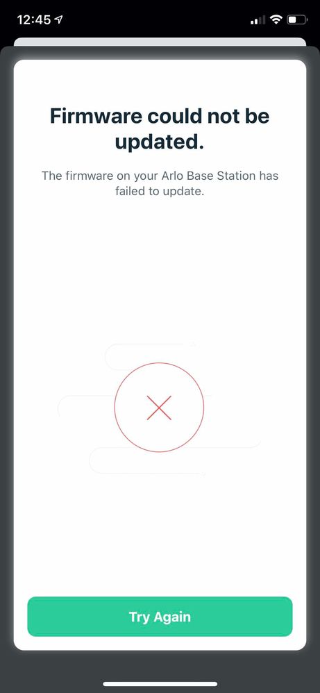

When I try to update base station I get a message saying device appears offline. Base station has three green lights on and it looks like it is connected. When I try to reconnect to the internet it shows an Authentication error has occured.
Hi @DMac40
I accidentally deleted the device. I did a hard reset and am installing it under New System Setup again. During installation, it found my base station but then moved on to checking for updates. Now that will not go any further than "firmware could not be updated". Now what me to do ?
Can u guys help me please!

Please contact the Support Team to further investigate this issue. You will find several options for contacting support in the provided link. Arlo Tech Support
