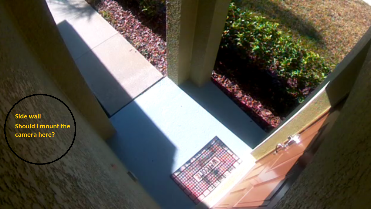

I am new to Arlo and the Arlo pro, and would like some advices on where is the best place to install the camera. Right now I have it installed on top (more to the right) of front door, and today I had a package delivered and the camera did not detect any motion. So my question is, would it be better to mount the camera against the side wall? See pictures below.
Also, what sensitivity % is recommended?

I see the pictures now.....
This is kind of a tough one since the area you are trying to cover is very short and narrow. Suggestions:
Crank up the sensitivity to 100% and test it out. Mimic a UPS delivery and see if the camera catches you. Remember those guys walk at a fast pace, place your box down and they are out of the frame failry quickly.
Install the camera at that secondary loction on your picture, adjust it so that the door is at the very right of the screen, then test again.
Looks like a stucco house, if you have the means to move the camera to the other side of the door without punching another hole on your house, I'd try that too.
Ps I had the same issue and moving the camera at different locations above the door did not work, so I ended up moving the camera to a tree covering the door. The green arrow shows where I had the camera first
I'm also a new owner and had a similar problem. I had mounted it above the front door high enough so that no one could grab it. Problem was, I was only getting a video of the top of heads. No real useful face or front video. At the advise of another member here I mounted it opposite the front door and aimed directly at the front door. Although I tend to get video's of the backs of people, I get a clear shot when they turn to walk away from my porch.
Another plus is that no one can see the camera as they walk up to my porch area. When it was mounted above the door, it was very obvious.
Like Hula mentioned... I have a similar opening and had to move the Arlo away from the door to capture people.
I was able to move it out 10 ft so when the pesron comes in it triggers, and as they leave ( or are at door ) it captures too. The whole thing is try several locations with temp mounting till you find what work best for you.
As a PS.. surprized the PRO didn't pick the person up...finding the trigger/record event is so much faster than the Arlos
