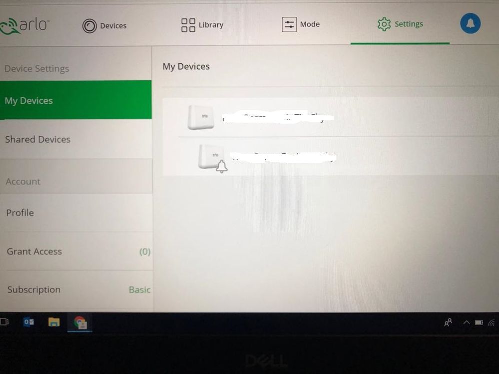

Yes I have claimed the first Base Station and i have I named it and the system has picked up the model and seriel number etc etc.
Then it automatically heads me into setting up cameras - does the correct hardware green lights and then blue lights and then it says finish and I think I'm all there - and then the device doen't refelct on our profile.
Just the Add Device icon again...
Very frustrating
I can even - activate the alarm from the laptop...
So there's something working - just camera's not syncing..
