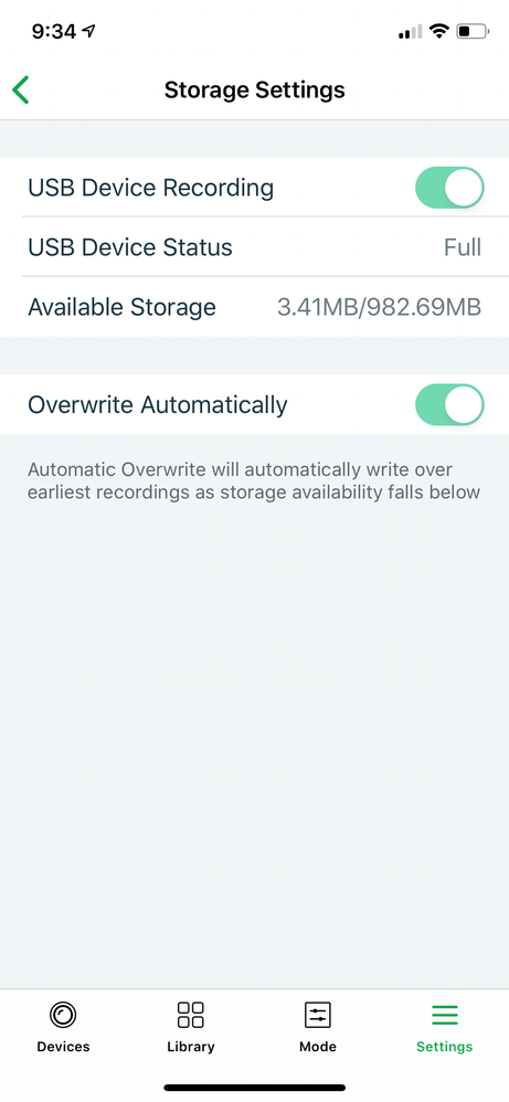

. My unit reports a full USB drive but computer shows 10.4MB free space.

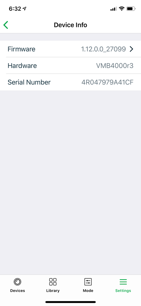

This issue is not resolved for me either. Once the drive is full, it quits recording and does not overwrite.
HW Version VMB4000r3
Firmware 1.12.0.0_27099

Yes, and I added the FW above. It's the latest version.

Have you tried contacting customer support regarding this issue? I have attached the link below for you - Arlo Tech Support
In addition I have included photos of the issue

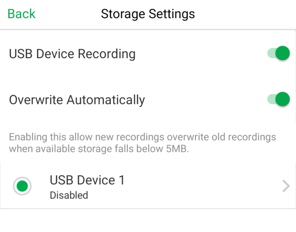

It looks like my 16gb usb memory is nearly full with videos dating back to April. It looks like it was still getting new recordings up to just a few minutes ago, but the app was showing the USB Memory status as Disabled. there is an app bug in there somewhere.
The USB memory has over 4000 videos. The strange thing is that June, July, September each only have ONE video (obviously that is wrong) and nothing for August. So I did have a real interruption somehow, or the algorithm that chooses what to overwrite went off the rails.

Hey @Mtam,
Just to make sure, after you connected your local storage driver, have you toggled on the "Automatic Overwrite" feature? You can find this by going to Settings > My Devices > Choose your Base Station > Local Storage. Otherwise, also try using a different local storage driver and see if it still persists.
I did toggle the "Automatic Overwrite" feature several times with no help. I will try another USB drive and report back. Thanks.
