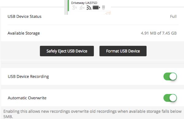

Hi @snip3rboy and/or @Timmy256 - I am having the same problem - with an 8 GB drive. Back in march i discovered the drive was full, pulled it, reformtted it in the base station - set to overright. Today, I just noticed it was greyed and had stopped writting to the drive. Base station reported the drive as full. Pull the drive and noticed the last video written to the drive was on JUL 30, therefore it has not saved any videos to local disk for the past 23 days.

discenter9999,
Just as a point of clarification...When you have your local storage driver connected do you also have the "Automatic Overwrite" feature toggled on? You can find this in Settings > My Devices > select your base station > Local Storage > Automatic Overwrite toggled on (green)
Hi @JamesC,
Overwright is ON (green) - in the current state you can see from the photo below, the BS reports the device is FULL and the status on the local says is grey/disabled.
@discenter9999 - I sent you a PM
