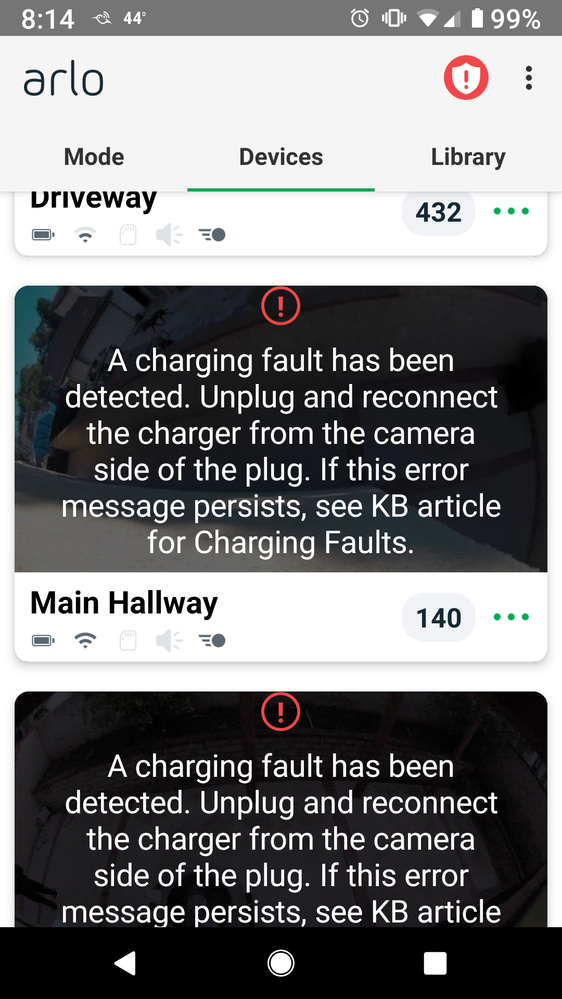

I have a Arlo Pro Base station which has 2 Arlo Pro cameras and 1 Arlo Pro 2 camera. It has never given me any issues with charging before in the year that I've owned it but the last time I tried to charge the Arlo Pro 2 camera it gave an error "A charging fault has been detected. Unplug and reconnect the charger from the camera side of the plug. If this error message persists, see KB article for Charging Faults".

OK thanks. The other thing I should have mentioned is that when I open the app on my phone I get the message on both cameras:
"A charging fault has been detected. Unplug and reconnect the charger from the camera side of the plug. If this message persists see KB article for Charging Faults."
I've no idea what the KB article is, but when I touch on the 'OK' box the message goes away. I have to do this every time on both cameras - why is this?
