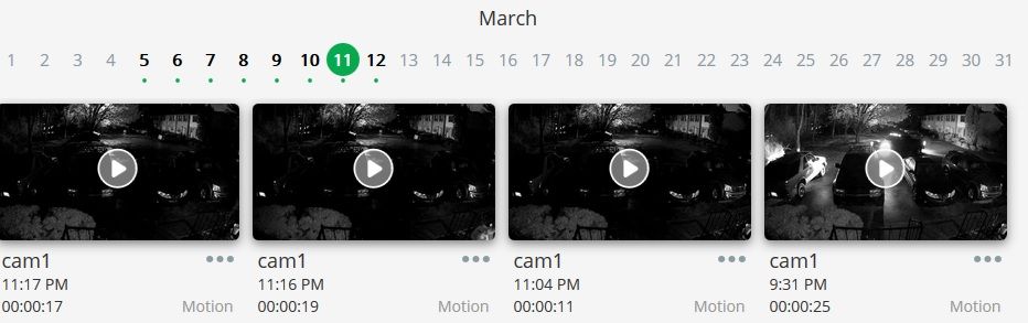

I have noticed our two Arlo Pro cams nightvision IR LED's have been slow to respond after the worldwide outage the other day?
Prior to the outage, the thumbnails in the library were vibrant and bright. After the outage was fixed, our library thumbnails are very dark. When playing back the video, it takes about a second for the IR's to illuminate after motion is detected. So, when the snapshot is taken the instant motion is detected, the IR LED's are not yet lit and the thumbnail is very dark. It seems like it is deteriorating over time. This is happening on both of our cams.
Anyone else having this problem?
Images attached here from bright to darkest with dates.

Here are thumbnails from some of my last night activity for cam 1 and 2.
The left thumbnail is a custom Truck with what seems like more light than the Sun if looking straight on. (exaggerating of course, but it's pretty damn bright in person.).
The right thumbnail is Rocky Raccoon looking for leftovers from our BBQ this weekend.

Oddly, around 4:30 this morning, several frames were "normal", as if someone were testing.
Changing the brightness, you can bring the thumbnail back to normal.
However, the video is then washed out.
Needless to say, it destroys the daylight videos.
