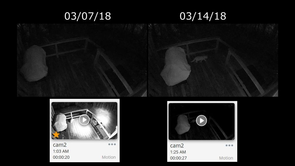

Attached is a 10 second 6.8mb video I put together with side by side comparison between March 7 and March 14 with the associated thumbnails. This is from our second cam which doesn't see much activity aside from our friendly neighborhood raccoon (which we call Rocky), and a roaming cat (which we call Sandy).
Click for video - https://streamable.com/afkgt
You can see the March 7 clip on the left takes the associated snaptshot/thumbnail a bit after 2 secs into the clip (nearly 80 frames).
This is frame 80.
The March 14 clip on the right takes the snapshot/thumbnail in the first frame, frame 1.
This is Frame 1.
Something has definitely changed after the outage.
That video is perfect, what more proof do they need. I was going to try and find some time to put a comparison together, but you nailed, shows exactly what the issue is. Nice job.

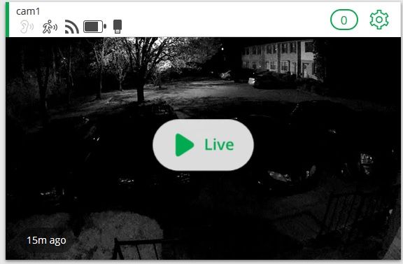

The preview screens are pretty dark as well.
This is a screen capture after a motion triggered recording - (obviously frame 1, cannot see what triggered the cam)
It was triggered by my neighbor who approached from the far right..
This is after clicking the live feed for a reset - (I'm guessing the last frame)
Also note in both images, you can see the porch light is on indicated by the shadows from the railings onto the front sidewalk. It is harder to see in the darker image, but it is there if you look closely.
Edit: And just for sh'ts and grins - here is a capture with NV disabled after clicking live feed.
