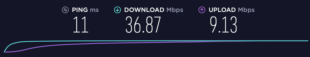

Gabriel_S
I have 37Mb download and 9Mb upload speed. The lag is strong with this one! Also my camera doesn't seem to see through a clear double glazed window or through the open wiondow for that matter, in broad daylight and I can't make-up a car number plate in my car park, the camera is on the first floor (2nd in UK) even on best quality video settings at about 25ft away. I'm a step away from packing it all in and send it back. For the money I've paid this is a joke.
