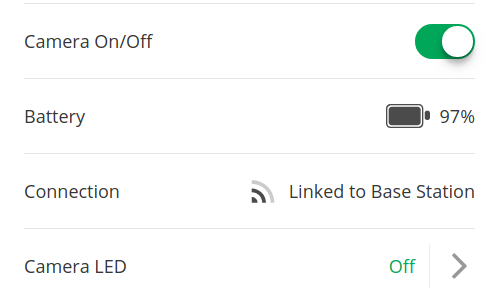

14 days since my last charge and still at 97%.
When I last charged I first removed the battery for a minute from the cam, then disconnected the power cable from base station for a minute or so. Seems to have made a difference.

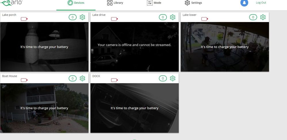

Arlo What is the update on this issue???? Take a look at the attached file. This is getting old especially when you 3 hours away from doing anything about it.
There has been a very significant loss of battery performance since around mid-year, as reported in all of these posts. It isn’t related to the batteries themselves, which don’t show the same rate of discharge when removed from the camera. This is a serious system defect, knowledge of which would now make a previously impressive security system unsaleable if it came to the notice if intending buyers.
