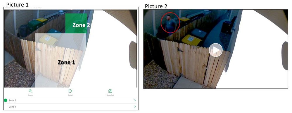

I have updated my Arlo Pro and have added activity zones (see attached image). I have it set to record motion. I'm assuming that it will (or should) only record motion within the zones I've created. I still get notifications of "motion detected" when my neighbor goes to the trash can, outside of the activity zones.
What am I doing wrong?
Since Arlo Pro is not wired apparently Activity Zone is not supported. You have shell out $ to get the cloud activity zone

I have that exact same question too and am also having issues with detections outside my activity zones (which I acknowledge is identified as an issue above). Hopefully someone can clarify. ![]()
Thanks for letting me know about the given instructions. To clarify, the activity zones only work with inclusion zones.

Thanks Jessica, so I take this to mean that if I draw a box (activity zone), the intention once things are fixed, is that it should only detect and alert me if there is movement withing that activity zone, correct?
