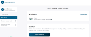

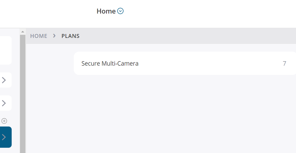

Hi Arlo community,
Been using arlo since 4 years ago. But with the upgrades and some new addon camera I quite lost in the system.
I have 4x arlo pro 2, 2x outdoor essential gen 2, 1x door bell gen 2. Everything works until this morning.
Seems I cant see any recording in my feed, I can view live tho, but no recordings or notification. Just suddenly stopped.
Then it asks me to subscribe. which I did. But couldn't figure out why its still not recording or no notification. When I go to settings (using PC), plan it says that my 7 devices are all connected into the plan.
Any help? thank you
