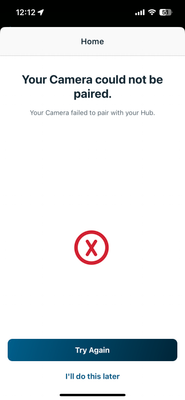

My pro 5 camera won’t pair to the keypad and árlos article on trouble shooting it says to tune on and off the secure link but there’s no option it just says pair. Yes it’s in the same network both devices are connected to the internet as well please help
Thenerd,
You must first have your Pro 5 camera onboarded and synced directly to your Wi-Fi network. Afterward, log in to the Arlo Secure mobile app and navigate to Settings (Blue person icon in the top left) > Locations and Plans (your location) > Devices > select your Pro 5 camera > SecureLink Connection > Pair
If the device can be found, it should then pair to the keypad. If you're having trouble, you might need to temporarily move the camera closer to the keypad to complete the process.
Yes I’ve done that and it says try again and I’m litter ally sitting in front of the keypad with the camera I’ve done a desert on both keypad and camera as well it’s in he same internet connection and still doesn’t connect to secure link
Thenerd,
Try removing the Pro 5 and re-onboarding. This can be done by navigating to Settings > Locations and Plans > Devices > Pro 5 > select Pro 5 Camera > remove device. This should automatically factory reset the camera.
After adding the camera back to your account, attempt the steps above again to sync to SecureLink.

Thenerd,
Are you able to verify the serial number of the camera you're trying to sync to SecureLink?
- Can you email me got off the phone tech support with no help n but to tell me to change the channel wifi on my erró which makes no sense when I’m trying to do a sexy re link and eveything is already connected to my internet
Removed keypad from my account and pro 5 camera and connected and synced eveything and still won’t pair to the keypad.
When I click pair keypad beeps twice camera is flashing blue then flashes amber twice then get the failed message like the screenshot I posted
couldn’t ben the single strength of the back up battery anencephaly cellular that’s connected to the keypad?
Thenerd,
I'm looking into this with the development team currently. I've escalated the details of your support case and the information provided here. I will post an update once I know more.
Thank you…. Do you think it has to do with the back up battery and cellular connected to the keypad or it doesn’t matter?
But so you know everything is connected to my internet no issue there the issue is pairing to the keypad with my pro 5 camera and went through all the troubleshooting steps from removing devices and adding them back.
Sorry if I’m repeating myself just want to make sure it’s clear and understand my post. Thanks again and hope you update me soon
