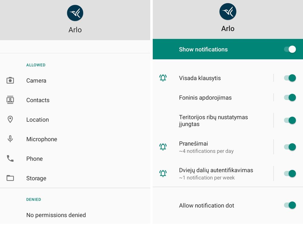

Yes, of course. The RLO application is granted full permissions and is allowed to display messages. I send screenshots of my phone

phone Caterpillar CAT S52, software for Android 10
Hmmm... Can't help you there - it may be a phone thing or older OS issue. If you temporarily subscribe you can try support via Settings, Support to report this as possibly the same issue as the others. When done dealing with support, unsubscribe.
